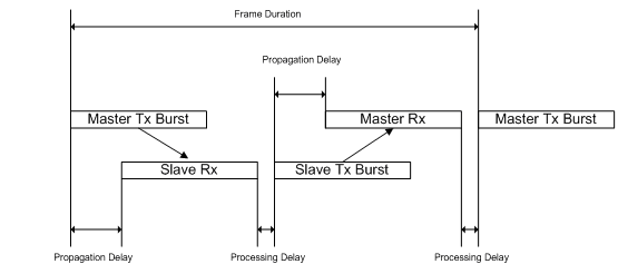

One cycle is called a Frame. The cycle period is called the Frame Duration. This is shown in Basic TDD Frame. For purposes of illustration, the delays in this diagram have been exaggerated.
_images/basic_tdd_frame.png
Basic TDD Frame
